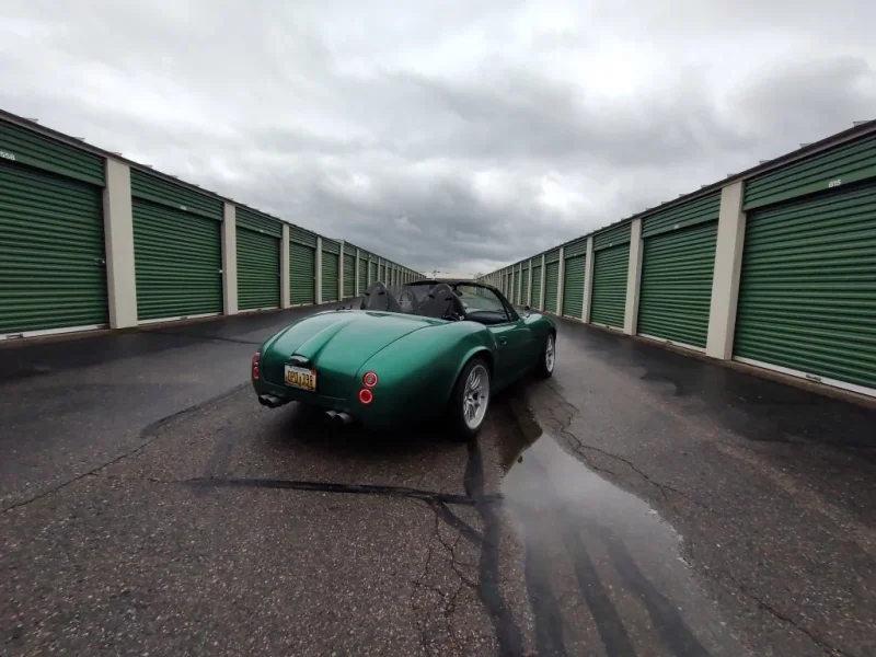

Took it to the first car show today and got a pretty nice reception! Then it started raining so I stopped for some glamor pics. More to come!
