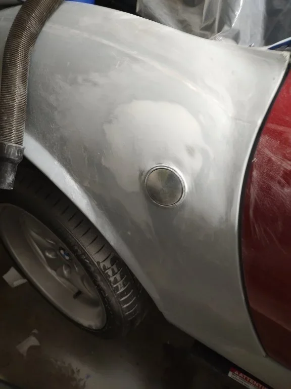

Started cleaning the body up. Sanding down all of the joining lines and making the area around the fuel filler look better.
I marked some spots here that I will address later, but both rear quarters will need to be modified quite a bit. I'll get to that in a moment...
I'm happy with how the fuel door turned out. It will be nice to be able to fill the car up at a gas station without getting weird looks. (Picture someone elbow deep into their wheel well fishing for the fuel cap.)

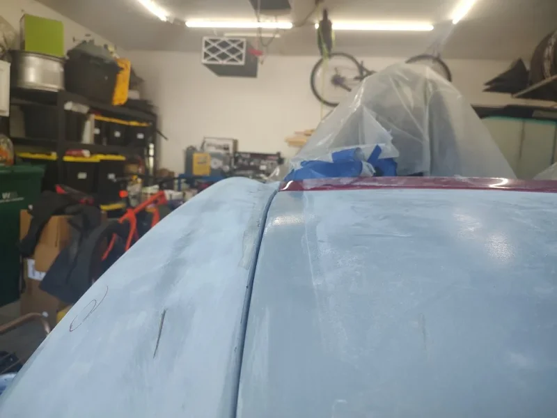

With the rear of the car on. I was able to get the trunk(boot lid) to sit in a way I like. First thing I did was mark some spots so I can take the trunk off and be able to put it back on right again. Then I sealed up areas around the opening so that water doesn't get into the ...what do we call the extended section? The hand bag holder? Maybe it'll help me organize groceries one day. Anyway, here we go:
Next step, sanding down high spots and working on panel gaps. The driver's side was sitting quite a bit higher then I would have liked, but I sanded it down and I think I got it relatively good enough ish.
The passenger side wasn't near as bad, but it still needed work.
The panels gaps are coming along, I'm very close to calling them good enough.
One of the last body shape questions I'm considering is dealing with the lip on the back..see here:
I'd really like it if I got the trunk flush with the bottom edge, but there are only two ways of doing that. Build up the trunk (meh) or build up the back side of the bottom edge and grinding off nearly 25mm of fiberglass. The more I think about it the more I'm thinking it's not that big of a deal. I will clean it up some and focus on fit and finish.

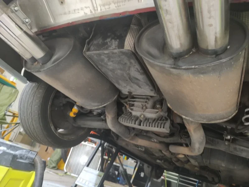

Now I have to figure out the trunk latch situation. My original idea was to use a classic hood pin, but upside down. The idea would be that the trunk lid would have the pin and you would unlock the trunk by reaching your hand under the lip of the body (between the exhaust pips). It occured to me that this car is very low and I am very tall. I'm re-considering my options. I can't put the standard 'T' handle under the license plate, there is no room. US license plates are taller than UK ones, so if I fitted a lock it would have to be either behind the license plate or off center. hmmm..
See? No room for a trunk latch. Unless off center somehow? Flip up license plate to reveil a latch?
