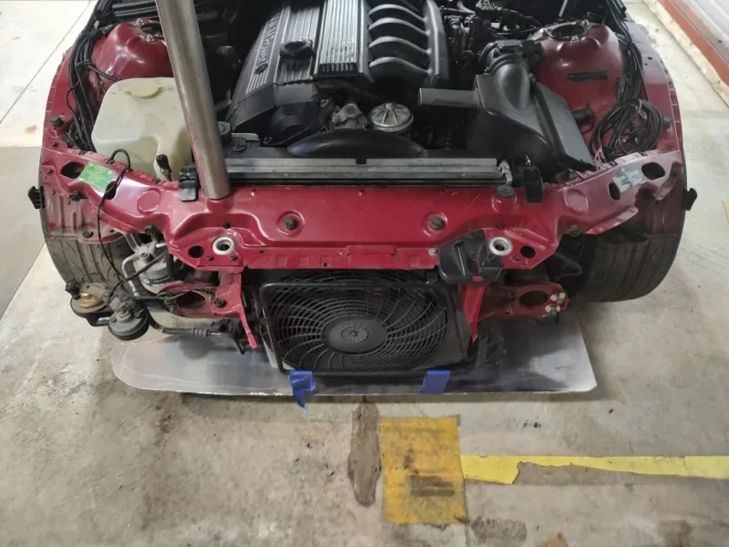

Here I started fitting an aluminum under tray. Made some brackets up and a bit more CAD work to do. That's cardboard aided design for those that were curious. I still have a ways to go for that yet.
Looking good, I used ABS sheet, a wall paper stipper heat gun, some Milliput, painted steel strips, rivets and bolts.

Re-worked the under tray. I might have to change it later but this gets the job done for now.
The notch on the right side is for access to the hood release. Speaking of...hood pins are done! This was trickier than I expected. I think because of the thickness of the fiberglass the method for locating the hood pins didn't quite work. The methodis to put a bit of grease on to top of the pins, lower the hood on to them, then drill the hole where the grease touched the hood. This didn't quite work out correctly so I had to re-work the pin locations...it all worked out in the end.

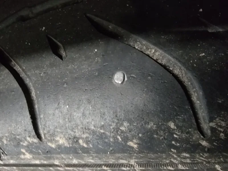

I started hacking up the original plastic wheel arches in the front of the car. Nearly done! They connect up to the under tray. I'm pleased with how they are coming along.
A fun thing about re-using these pieces is that I still have an opening to cool the brakes. I'm thinking I might add some ducting to align with the front grill at some point.
